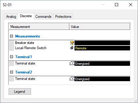

Now let's configure Discrete Measurements on Breaker 52-01. The first Measurement to configure is the one representing a Local or Remote status of a Switch.
1.Select the Discrete tab on Power Configuration object and click Add Add. Fill in the Name, Electrical Phase, Description, and Sorting columns with the following values:
Electrical Phase: -1 - epNone
Description: Local/Remote Switch
Sorting: 1000
2.Create a new Meaning by clicking Add Add. Configure the Meaning and Description columns as "Remote", Application Value as 0 (zero), and Source Value as 0 (zero).
3.Create another Meaning, configuring the Meaning and Description columns as "Local", Application Value as 1 (one), and Source Value also as 1 (one).
4.On this Substation, right-click folder Measurements on Breaker 52-01 and select the Insert - Discrete Measurement option.
5.Configure this Discrete Measurement with the following values:
MeasurementType: LR, on the Type column
NOTE
As an Analog Measurement, there is an option to insert a SCADA-type Measurement Source and then link it to an I/O Tag.
6.Execute this application and test this new functionality.
Discrete tab
Discrete tab
7.Repeat the creation of Discrete Measurement LocalRemote for all Breakers.
8.Execute this application and test this new functionality.
