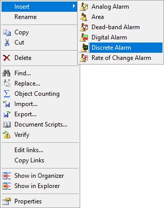

1.On Substation SE1, Breaker 52-01, select Measurement BreakerPosition on folder Measurements and, using its contextual menu, select the Insert - Discrete Alarm.
Inserting a Discrete Alarm

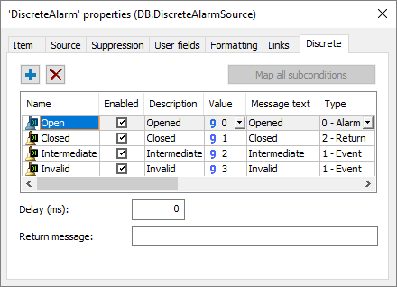

2.Right-click this Discrete Alarm and, on its Properties Window, select the Discrete tab and configure it with the values on the next table.
Configurations of Discrete tab
Name
Message Text
Type
Open
Open
0 - Alarm
Closed
Closed
2 - Return
Intermediate
Intermediate
1 - Event
Invalid
Invalid
1 - Event
Discrete Alarm Subconditions
