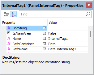

If an object is created with the Activate parameter in False, later it can be activated by using the Activate method. The type of an object can be viewed on the title bar of the Properties List.
Rectangle object (DrawRect)
Internal Tag object (InternalTag)
