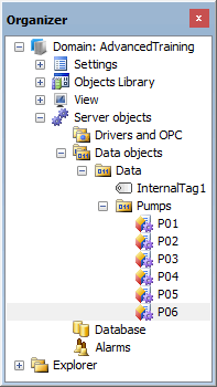

To simplify a future logic, let's separate XO_Pump XObjects in a folder called Pumps.
1.In the Data Server, folder Data, insert a Data Folder called "Pumps".
2.For each pump on the Screen, insert on Pumps folder an XO_Pump XObject. Configure the Name property to "P01" and the DocString property to "Pump01" in the first pump and name all others sequentially.
Pumps Folder
Name and DocString properties

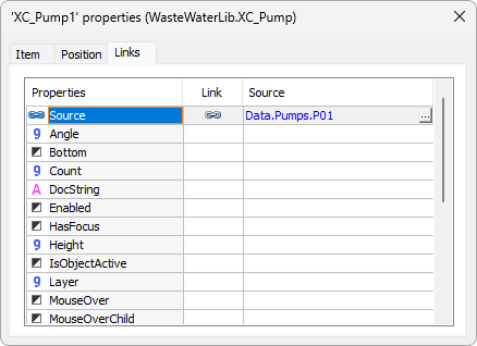

3.Link the XC_Pump XControls of the Screen with the XObjects created.
Link with XObjects
