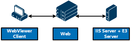

Possible configurations to organize Elipse E3 servers and IIS are E3 Server and IIS on the same server or on different servers. This Tutorial only covers the first option. Detailed information about this issue can be viewed on Elipse Knowledgebase, in the article Publishing Elipse E3 version 3.0 applications on the Internet with Microsoft Internet Information Services.
