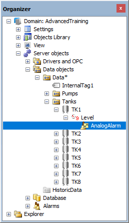

Every tank must have an Alarm monitoring its level information.
1.Insert in the instances of XFolder XF_AnalogMeasurement (Level) an Analog Alarm.
Analog Alarm

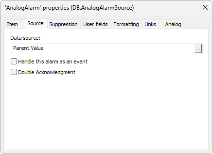

NOTE |
When creating this Alarm, the Source property is automatically configured to monitor the Value property of the Level object, according to the next figure. |
Data source of an Analog Alarm

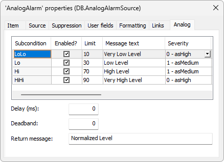

2.Configure the levels and messages of the Analog Alarm as desired.
Configuration of the Analog Alarm

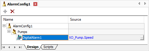

Every pump must show when it is turned on or off.
1.Insert in the XObject XO_Pump an Alarm Configuration object.
2.In the AlarmConfig1 object, insert a new Area named "Pumps".
3.In the Pumps Area, insert a Digital Alarm for the XO_Pump.Speed property.
