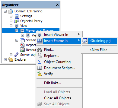

1.Right-click the Viewer and Frames item and select the Insert Frame in - E3Training.prj option.
Insert Frame In option

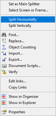

2.On Frame's viewing area, right-click it and select the Split Horizontally option, according to the next figure.

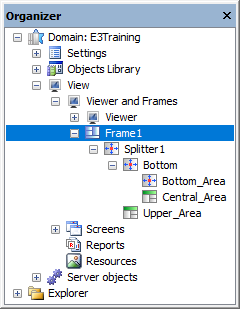

6.Name this Splitter as "Upper_Area". To change an object's name, these are the options:
•Select the object in Organizer and press the F2 key to enable name edition
•Select the object in Organizer and, on object's Properties List, change the Name property
•Right-click the object in Organizer and select the Rename option
Splitter renamed

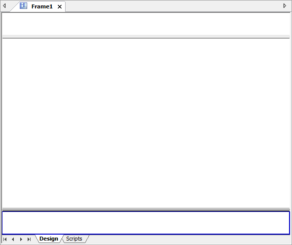

7.Split the bottom Frame horizontally about 10% of this Screen, from its bottom limit.
Position of the lower bar
8.Name these Splitters as "Central_Area" and "Bottom_Area", respectively.
Frame Splitters

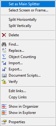

9.Configure the Bottom_Area Splitter as Main. This forces E3 to comply to Splitter size and the remaining Screen is the Central_Area Splitter's size. Right-click the Bottom_Area and select the Set as Main Splitter option.
10.Configure the size of the Bottom_Area Splitter as "10%" (SplitValue property).
11.Change the SplitBorder property of Bottom_Area Splitter to False.
