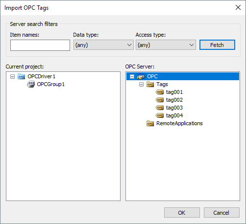

5.The next step to configure is importing Tags. Close the properties window and right-click this OPC Driver and select the Import Tags option to open E3's Import OPC Tags Wizard.
Import OPC Tags window
6.The previous figure shows the appearance of an import window. On the right side there is a list of server Tags and, on the left side, there is an import area for E3. To import, first set a filter, select an item, and then drag it to a destination OPC Group.
