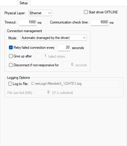

The Setup tab contains general configurations of a Driver. This tab is divided into the following groups:
•General configurations: Configurations of a Driver's physical layer, time-out, and initialization mode
•Connection management: Configurations on how the I/O Interface keeps a connection and which recovery policy is used on failure
•Logging options: Controls the generation of log files
Setup tab
Setup tab
General options on the Setup tab
