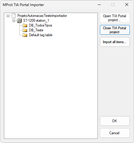

After authorizing MProt TIA Portal Importer, it is opened displaying the tree structure of a project with the items to import.
Items to import
Items to import
To import all Tags from a project, click Import all items. After finishing the import process, click OK to confirm it and close the Importer. When closing the Importer, the Tags are automatically imported into the configuration window of this Driver, where they can be saved. For more information, please check topic Importing Tags. The Close TIA Portal project option allows closing a project and the Cancel option closes the Importer without performing an import process.
