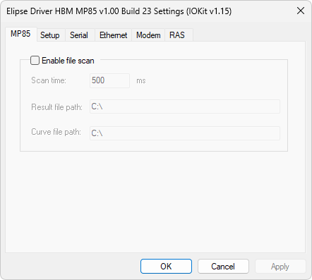

This Driver does not use [P] configuration parameters. All configurations must be performed on the configuration window, shown on the next figure.
MP85 tab
MP85 tab
Available options on the MP85 tab
Option
Description
Enable file scan
Enables or disables reading curve files
Scan time
Period to scan for new files
Result file path
Specifies a path to store parameter files, with an .R85 extension
Curve file path
Specifies a path to store curve files, with .C85 (success) or .D85 (failure) extensions
