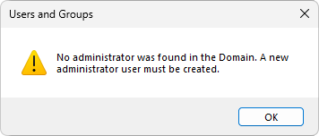

1.Select the File - Users menu. As this application does not have any registered user yet, click OK on the dialog box shown on the next figure to create an administrator user.
Application without an administrator

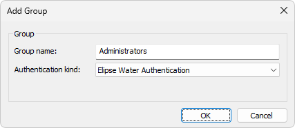

2.Select the Groups item and create two groups of users, named "Administrators" and "Operators".
Add Group window
Add Group window

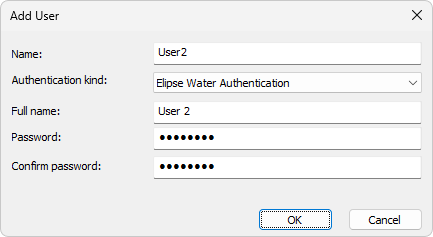

3.Select the Users item and create three more users, besides the Domain's administrator user. Be careful with uppercase and lowercase characters.
Add User window
Add User window

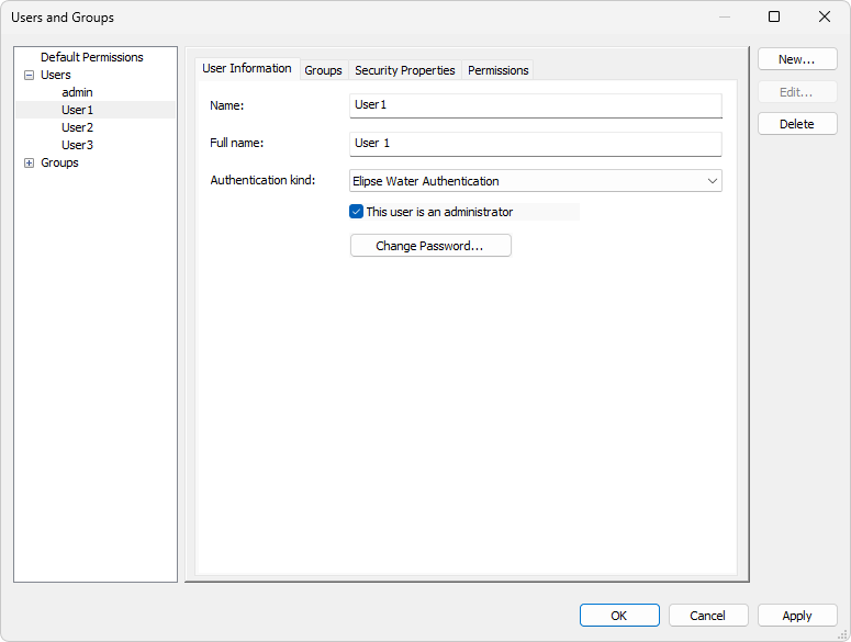

6.Open the Users and Groups window again, select one of the users created after the administrator, and select the This user is an administrator option for this user.
NOTE
Users with the This user is an administrator option selected cannot be removed or changed by users without that option selected, both at run time and on Elipse Water Studio.
7.Configure this user to belong to the Administrators group and the other two users to belong to the Operators group.
