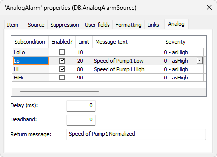

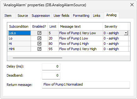

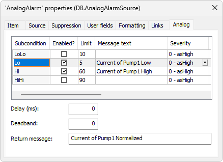

3.Add Analog Alarms on Measurements Current, Flow, and PumpSpeed of the Pump1 object of the Station1 Station of the System1 Water Distribution Network and configure the properties of these Alarms according to the next figures.
Analog Alarm on Current Measurement
Analog Alarm on Flow Measurement
Analog Alarm on Speed Measurement
