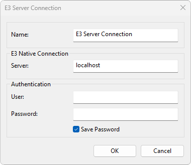

Allows connection an Elipse E3, Elipse Power, or Elipse Water server. The configuration is performed on the window of the next figure.
E3 Server Connection window
Available options on the E3 Server Connection window
Option
Description
Name
Name of the Connection
Server
Name of an Elipse E3, Elipse Power, or Elipse Water server. To connect to a server on the local machine, use the expression "localhost", and for servers on a network, use the format \\SERVERNAME
User
Name of a user
Password
Password of the user
Save Password
Enables saving the informed password
