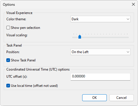

When clicking Options, the window on the next figure is shown.
Options window
Options window
Available options on the Options window
Option
Description
Color theme
Allows selecting a theme for the graphical interface of Elipse TrendExplorer. The available options are Light or Dark
Show pen selection
Shows the highlighted Pen on Displays
Visual scaling
Allows configuring the scale of visual elements on Elipse TrendExplorer. Possible values for this option range from 50% and 500% and the default value is 100%
Position
Allows selecting a position for the Task Panel. The available options are At the Top, At the Bottom, On the Left, or On the Right
Show Task Panel
Enables displaying the Task Panel
UTC offset (s)
Allows indicating a timezone, in seconds, to Pen's time on Displays
Use local time (offset not used)
Uses the local time, disregarding the UTC offset (sec) option
