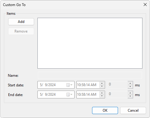

When selecting the Edit option, the window on the next figure is shown.
Custom Go To window
Custom Go To window
Available options on the Custom Go To window
Option
Description
Add
Adds a new pre-determined period
Remove
Removes the selected period
Name
Sets a name for this pre-determined period. This name is added to the options on the Go To menu
Start date
Initial date and time of a pre-determined period
End date
Final date and time of a pre-determined period
