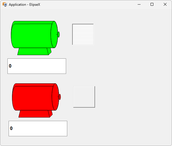

Let's suppose a certain application needs to supervise and command 10 engines. Each engine must be represented by a drawing on a Screen, which displays a green color when operating and a red color when turned off. It must also display the engine command on the Screen, sending instructions for turning it on and off, and also displays its speed.

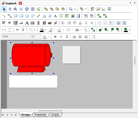

One possibility is to create an XControl called EngineA, with properties Status set to Boolean and Speed set to Double, according to the next figure.
Design tab
Design tab
Properties tab
Properties tab
1.To indicate color, engine's OverrideFillColor property must be linked to XControl's Status property, by using a Digital Link. Set the OverrideFillMode property to 2 - SolidFill.
2.To display speed, Display's Value property must be linked to XControl's Speed property.
3.The Toggle Button switches the Status property value via a Simple Link.
