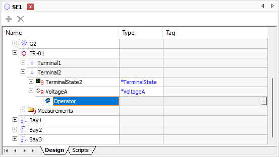

1.Electrical information must be collected on device's terminal, therefore let's create the Measurements on Terminal2.
2.Right-click Terminal2 of Transformer TR-01 and select the Insert - Analog Measurement option.
3.Rename this Measurement to "VoltageA".
4.Configure the Measurement type as *VoltageA (on the combo box).
5.Select the measurement source Operator and define an initial value for it.
Analog Measurement
Analog Measurement

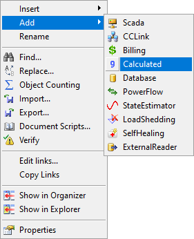

8.Measurement CurrentA must be the sum of currents of the other Breakers, therefore this is a calculated value. Select Measurement CurrentA and insert a source of type Calculated.
Add Calculated
Add Calculated

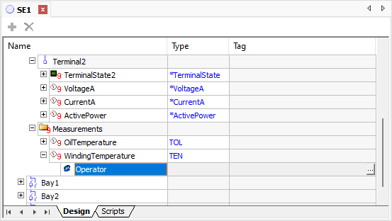

2.Go back to the Substation and configure its Measurement type as TEN (on the combo box).
3.Define an initial value for the Operator source of this Measurement.
Temperature Measurement

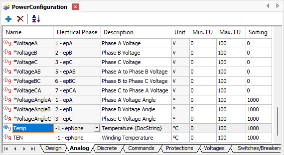

1.Select the Analog tab of Power Configuration object. Select the TOL standard and reconfigure it as indicated:
•Name: Temp
•Electrical Phase: -1 - epNone
•Description: Temperature {DocString}
•Unit: °C
•Min. EU: 0 (zero)
•Max. EU: 100
•Sorting: 1000
Temp Template
Temp Template

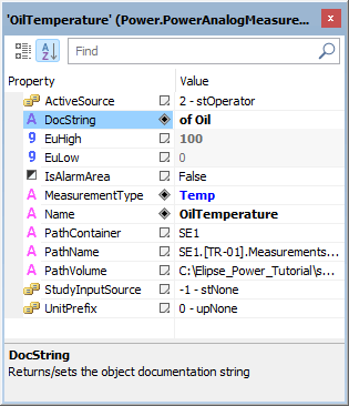

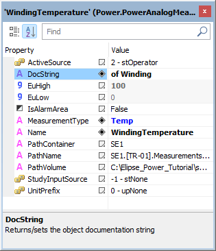

3.Configure the DocString property of Measurement OilTemperature with the text "of Oil".
4.Repeat the previous procedure for Measurement WindingTemperature, configuring the DocString property as "of Winding".

DocString property of Winding Temperature
Notice that, with this solution, the Temp standard becomes available for any temperature measurement, allowing users to specify, in the measurement, where this value is measured.
