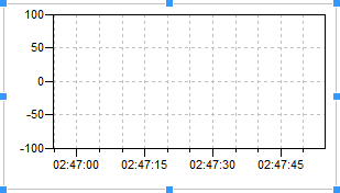

An E3Chart object is an ActiveX component used to show a chart displaying Tags varying in real time, and to show historical data stored on a database.
