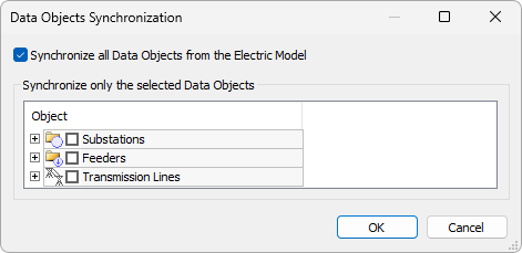

The window on the next figure is then opened. By default, the Synchronize all Data Objects from the Electrical Model option is already selected, indicating that all objects are synced.
Data Objects Synchronization window

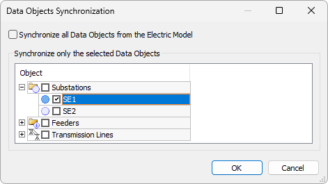

If users want to sync specific objects, deselect the Synchronize all Data Objects from the Electrical Model option and select the specific objects on the Synchronize only the selected Data Objects group, according to the next figure.
Syncing only the selected objects

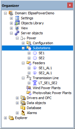

Users can view objects created and changed using Organizer. Data objects that were created already have some basic configurations, but allow inserting elements on them, such as Measurements, Commands, Interlocks, Alarms, Storage objects, Data Folders, Scripts, and in some cases other Elipse Power data objects.

Result of syncing process
