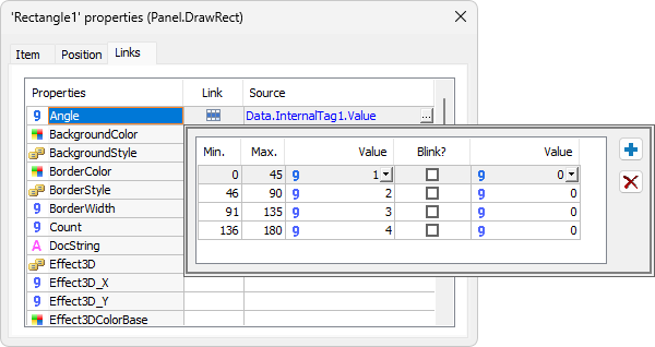

In a Table Link, users can establish a set of intervals based on the minimum and maximum source values and, for each one of these values, a value to be assumed by a property. In addition, as in a Digital Link, users can specify a Blink option and an alternative value.
Table Link
The available options for this Link are described on the next table.

To use this resource, follow these procedures:
1.Right-click an object and select the Properties option.
2.Select the Links tab, click the Link column of a property, and then select the Table Connection
option.
3.Add rows to the table and configure the respective Min, Max, and Value options.
4.If users must alternate periodically among values, enable the Blink column and then configure the Value column.
