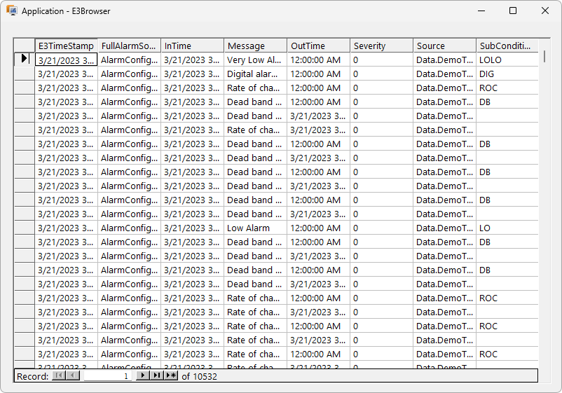

An E3Browser is an ActiveX control used for viewing data stored on a database. Users can configure queries using several types of filters on data and assign colors for each column, among other settings. This object is used to view historical data, alarms, or any existing table on a database.

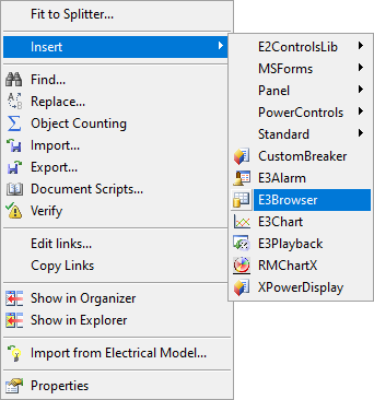

To use this feature, follow these procedures:
1.Insert an E3Browser in the project, by right-clicking the working area and then selecting the Insert - E3Browser item.
Inserting an E3Browser on a Screen
