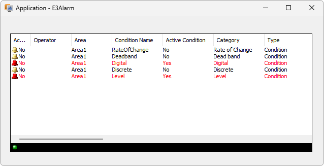

Starting with version 4.7, an E3Alarm allows viewing the status of Connections configured on the Connections tab. To enable that status bar, configure E3Alarm's ShowConnectionStatusBar property on Properties List. The next figure displays a status bar enabled.
E3Alarm's status bar for Connections
