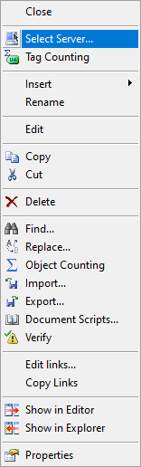

To configure an OPC UA Driver, right-click this object and select the Select Server Select Server item.
Select Server option

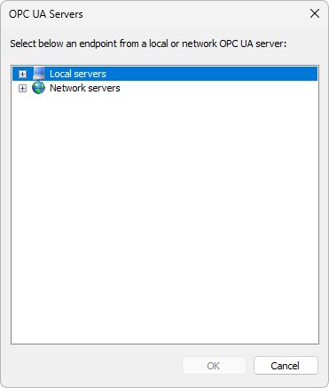

The following window is then displayed, allowing to select an OPC UA Server on a local computer or on a network.
OPC UA Servers window
For each OPC UA Server, locally or on a network, endpoints are enumerated, which can use different protocols and security modes. In addition, for each endpoint an OPC UA Server can also support different ways of identifying and authenticating users.
Currently, Elipse Power allows a connection only using the Binary TCP mode. For this mode, Elipse Power supports security modes defined by the OPC UA standard, with several combinations of security policies. For authentication, Elipse Power only supports Anonymous and User and Password modes.
NOTE
The OPC UA Servers window lists all protocols and security modes for user information. However, only Elipse Power compatible modes can be selected.
When selecting an Elipse Power compatible endpoint, the EndPointURL, SecurityMode, and SecurityPolicy properties of this object are automatically filled in.

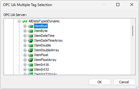

Click Yes to create an OPC UA Subscription and open the window on the next figure, where users can select OPC UA Tags for importing.
OPC UA Multiple Tag Selection window
On this window, users can use the key combination CTRL + Mouse click to select non-consecutive OPC UA Tags and SHIFT + Mouse click to select a range of OPC UA Tags.

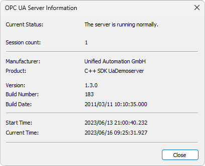

Notice that to edit OPC UA Driver properties it may be necessary to deactivate communication. If communication is active in Elipse Power Studio, then users can open a window with information about the selected OPC UA Server by selecting the Information About Server Information About Server option on object's contextual menu, shown on the next figure. In case a connection is not established, for any reason, this window displays question marks instead of OPC UA Server information.

When selecting the Tag Counting Tag Counting option, the window on the next figure is displayed, allowing to view the number of OPC UA Tags available on an OPC UA Driver.
