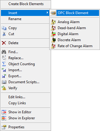

To use this resource, follow this procedure:
1.Right-click an OPC Block and select the Insert - OPC Block Element option.
Inserting an OPC Block Element
