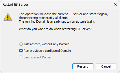

If a Domain was defined to start automatically on the Start Up window, the window on the next figure is displayed.
Options to restart an E3 Server with start up configured
The available options on this window are Just restart, without any Domain, which only restarts E3 Server, Run previously configured Domain, which restarts E3 Server and loads the Domain configured on the Start Up window, and Load Current Domain, which restarts E3 Server and loads the current Domain, if E3 Server was stopped while a Domain was executing.

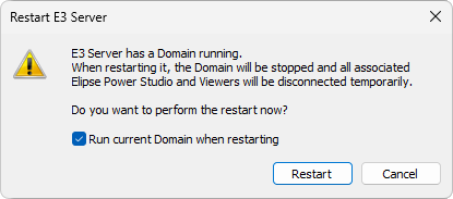

If no Domain was defined to start automatically, the window on the next figure is displayed.
Option to restart an E3 Server without start up configured
In this case, E3 Server is restarted, and users can opt by executing or not the current Domain by selecting or deselecting the Load current Domain when restarting option.
NOTE
By default, E3 Server is restarted using the user who stopped the Domain, but if the Domain configured for starting up is different from the Domain before restarting, the login window can be displayed for authentication in this new Domain.
