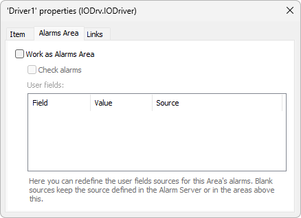

Server objects have the possibility of behaving as Alarm Areas. These objects have an additional tab, Alarms Area, where this behavior can be enabled and configured. The next figure shows that tab on an I/O Driver.
Alarms Area tab
Available options on the Alarms Area tab
Option |
Description |
Work as Alarms Area |
Enables or disables an Alarm Area behavior for a Server object. This option corresponds to the IsAlarmArea property of an object |
Check alarms |
Enables or disables Alarm check on an object. This option corresponds to the AlarmVerify property of an object |
User fields |
Please check topic User Fields Settings for more information |
