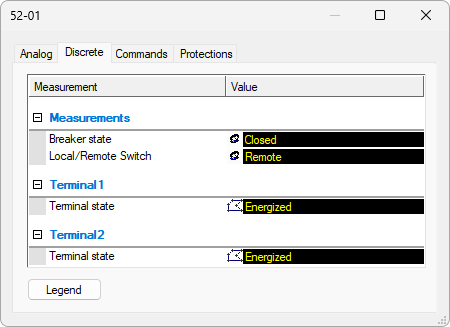

6.Execute this application and test this new functionality.
Discrete tab
Discrete tab
7.Repeat the creation of Discrete Measurement LocalRemote for all Breakers.
8.Execute this application and test this new functionality.
