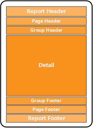

A Report contains several Sections. Each Report Section contains a group of controls that are processed and printed at the same time, as a unit.
Report Sections
A Report is structured as described on the next table.
Report structure
Section |
Description |
Report Header |
This Section prints at the beginning of a Report. It is used for printing Report headings, sum tables, charts, or any other information that must appear only at the beginning of a Report |
Report Footer |
This Section prints at the end of a Report. It is used for printing a Report sum, grand totals, or any other information that must be printed once at the end of a Report |
Page Header |
This Section prints on top of every page of a Report. This is the first Section printed on a page, except when this page contains a Report Header Section. It is used for printing column headings, page numbers, page titles, or any other information that must be printed at the beginning of every page |
Page Footer |
This Section prints once at the bottom of every page of a Report. It is used for printing page totals, page numbers, or any other information that must be printed once at the bottom of every page |
Detail |
This Section is the body of a Report, which prints once for every record on a data source |
Group Header, Group Footer |
A Report may have multiple nested groups. Each group contains a Header Section and a Footer Section. A Header Section is printed right before any Detail Section in this group. A Footer Section is printed right after a Detail Section in this group |
