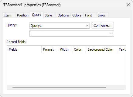

1.Insert an E3Browser
on Event_Screen.
2.To configure data displayed by this E3Browser, open its properties window and select the Query tab.
3.Select Query1 and click Configure.

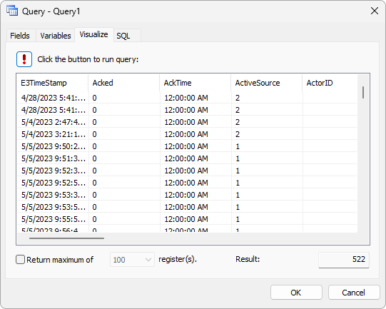

7.Open the Visualize tab and click Execute Query
to check this Query's result.
Execute Query

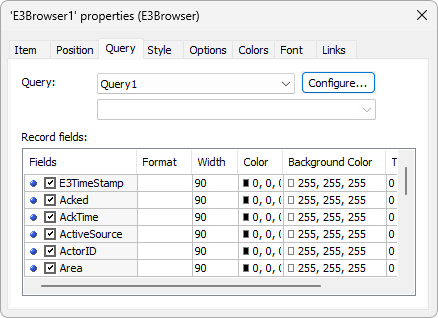

8.Click OK. After finishing this step, all fields listed on this Query are available in the E3Browser. Configure each field with the desired color, format, and size.
Field configuration
9.Execute the application and open Event_Screen to test this new functionality.
