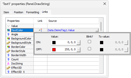

A practical example is either to change the color of a text on a Screen to green when a Tag is turned on, that is, its value changes to 1 (one), or to red when it is turned off, that is, its value changes to 0 (zero). In this case, simply create a Digital Link between Text1's TextColor property and Tag1. Links are preferable due to execution speed and also simplicity in maintaining and building applications.
Linking text color to Tag1's value
