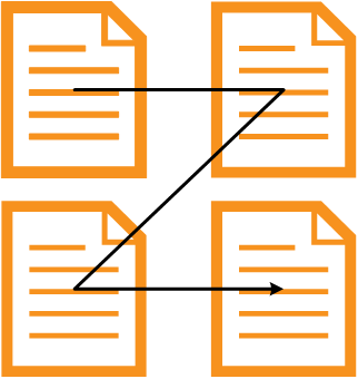

1 - ddCDAcrossDown |
Prints each column of a Detail Section from right to left and so on |
The layout is determined according to the configured option, as shown on the next figures.
ddCDDownAccross option
ddCDAccrossDown option
