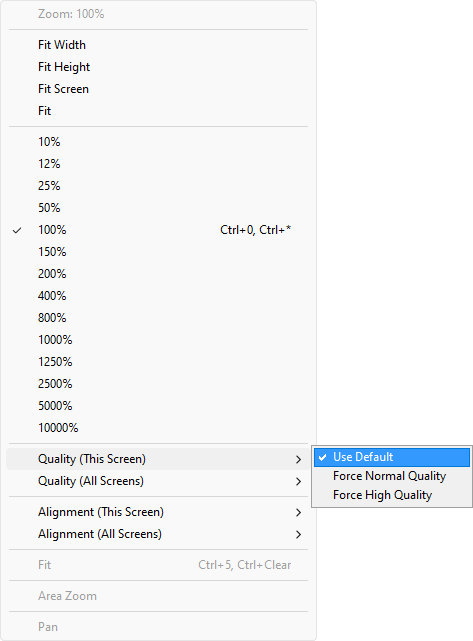

The following figure displays a Screen's contextual menu at run time, with all respective configuration options for this property.
