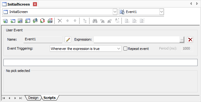

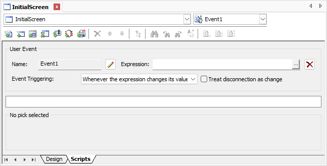

2. Type a name for this event and click OK to open this user event's View, according to the next figures, which describe the available options for this event triggering.
Whenever the expression changes its value option
Whenever the expression is true option

Option |
Description |
Name |
Name that identifies this event. This option is not editable, so click Rename User Event |
Rename User Event |
Opens a window to change the name of this event |
Expression |
Expression generating this event. Click |
Remove User Event |
Removes this event from the List of Events. NOTE: When removing a user-defined event, all scripts associated to that event are lost |
Event Triggering |
Specifies a condition so that this event occurs. Possible options are Whenever the expression is true or Whenever the expression changes its value. In the first case it is an etOnEvent type (the event occurs whenever its expression is true) or an etWhileEvent type (the event occurs cyclically, at pre-defined intervals). In the second case the event is an etOnValueChanged type (the event occurs whenever its expression changes its value) |
Repeat event |
When available, indicates that this event is an etWhileEvent type, that is, this event repeats while its expression is true. This option is only available when the Event Triggering option is configured as Whenever the expression is true. The repetition interval is configured in the Period (ms) option |
Period (ms) |
Repetition interval, in milliseconds, of this event. This option is only available when the Event Triggering option is configured as Whenever the expression is true and the Repeat event option is selected |
Treat disconnection as change |
Indicates that a connection or disconnection of the expression generating this event must be handled as a change. This option is only available when the Event Triggering option is configured as Whenever the expression changes its value |

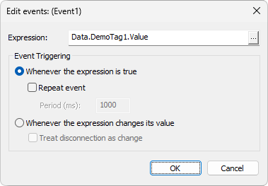

4. To change this event using an object's Scripts tab, select it on the list of events. A user event can be also edited using the Edit Links option of an object's contextual menu. On the Edit Links window, click the Connection column corresponding to this event and, on the contextual menu, select the Edit option to open the window on the next figure.
Edit events window
