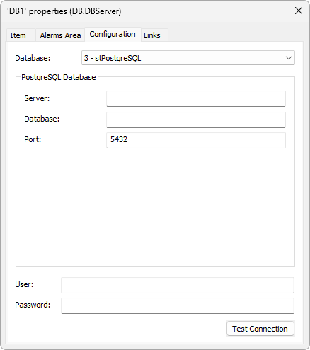

To insert a new PostgreSQL Database, follow these procedures:
1.Right-click the project's name in Explorer and select the Insert - Database option. In Domain mode, right-click the Server objects - Databases item, select the Insert Database In option, and then the project's name. The object is then created and its script edition window is opened.
2.To configure it, go to the Configuration tab on the Properties Window.
Configuration for PostgreSQL Databases
Available options for the Configuration tab

The minimum version of PostgreSQL server supported by Elipse Power is 10.
3.In the Database option, select the 4 - stPostgreSQL item.
4.Configure the Server option with the name of a PostgreSQL server.
5.If needed, configure the User and Password options according to the settings of a PostgreSQL server.
6.Click Test Connection to check whether these settings are correct and then click OK to save these settings.
