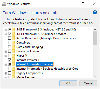

1.On Windows 10 or later, click the Start menu, select Settings, and then click Apps.
2.On Apps & features, click Optional features.
3.Click More Windows features.
Windows Features window
4.Locate the Internet Information Services item on the list and click Expand to expand all its sub-items.
5.Select, at least, the following options and click OK.
