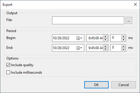

When clicking Export to CSV, the window on the next figure is displayed.
Export window
Export window
Available options on the Export window
Option
Description
File
Allows indicating an output file for exporting. Click Select directory to select an output directory
Begin
Allows selecting a date and time to start exporting
End
Allows selecting a date and time to finish exporting
Include quality
Allows including a Pen's quality on export
Include milliseconds
Allows including milliseconds in the indicated periods

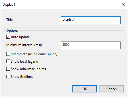

When clicking Edit, the window on the next figure is displayed.
Edit window of a Display
Available options on the edition window of a Display
Option
Description
Title
Title of a Display
Auto update
Enables or disables the auto update mode
Minimum interval (ms)
Minimum updated interval, in milliseconds. The minimum accepted value in this options is two seconds, or 2000 ms
Interpolate (using cubic spline)
Uses a cubic spline interpolation to draw a Display
Show local legend
Shows or hides a legend with the Pen's name and its respective color
Show min./max. points
Shows or hides the maximum and minimum points on a Display
Show Gridlines
Shows or hides the grid lines on a Display

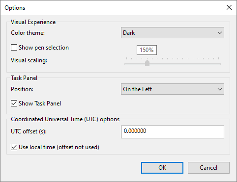

When clicking Options, the window on the next figure is displayed.
Options window
Options window
Available options on the Options window
Option
Description
Color theme
Allows selecting a color theme for a Display. Possible values are Light or Dark
Show pen selection
Shows the highlighted Pen on a Display
Visual scaling
Allows configuring the scale of visual elements on TrendAnalysis. Possible values for this option range from 50% to 500% and the default value is 100%
Position
Allows selecting the position to show the task panel with the Displays, Bookmarks, and Connections tabs. Possible values are At the Top, At the Bottom, On the Left, or On the Right
Show Task Panel
Shows or hides the task panel
UTC offset (s)
Allows indicating a time offset, in seconds, to the time of Pens on a Display
Use local time (offset not used)
Uses the local time, ignoring the UTC offset (s) option

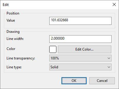

Horizontal and Vertical Guide Lines are part of a set of functionality that helps an analyst in the process of visually analyzing data. The main function of Guide Lines is to help the visual identification of periods in which data exceeds the limits defined by the Lines.
To add a Horizontal Guide Line, right-click the area of a Display and select the Add Horizontal Guide Line option. To move a Horizontal Guide Line, click and drag it to the desired position. To edit it, right-click the Guide Line and select the Edit option to show the window on the next figure.
Window to edit a Horizontal Guide Line
Available options on the Edit window of a Horizontal Guide Line
Option
Description
Value
Value of the Guide Line's position relative to the Vertical Scale
Line width
Line's width, in pixels
Color
Color of a Guide Line. Click Edit Color to select a color on the Windows default color selection window
Line transparency
Level of transparency of a Guide Line, as a percentage. Possible values range from 10% to 100%
Line type
Type of line. Possible values are Solid: Solid line, Dash: Dashed line, Dash Dot: Line with dashes and dots, Dash Dot Dot: Line with dashes, dots and dots, and Dot Dot Dot: Dotted line

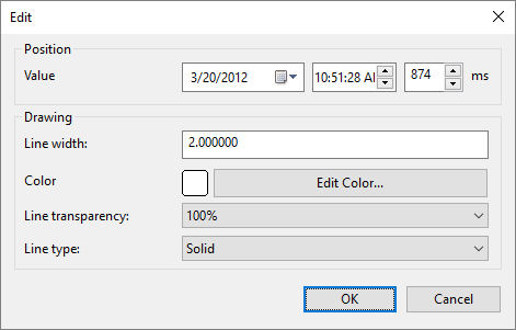

To add a Vertical Guide Line, right-click the area of a Display and select the Add Vertical Guide Line option. To move a Vertical Guide Line, click and drag it to the desired position. To edit it, right-click the Guide Line and select the Edit option to show the window on the next figure.
Window to edit a Vertical Guide Line
Available options on the Edit window of a Vertical Guide Line
Option
Description
Value
Value of the Guide Line's position relative to the Horizontal or Time Scale
Line width
Color
Line transparency
Line type

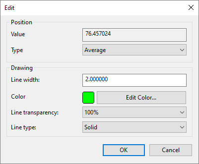

Users can also add a Horizontal Guide Line linked to a Pen. To do so, right-click a Pen and select the Add Associated Horizontal Guide Line option. In this case, the Guide Line moves automatically to the average, minimum, or maximum value of the linked Pen. The window to edit this type of Guide Line, available in the contextual menu's Edit option, contains an extra Type option, shown on the next figure.
Window to edit a Horizontal Guide Line linked to a Pen
The available options for the Horizontal Guide Line linked to a Pen are Minimum: The Guide Line moves automatically with the minimum value, Average: The Guide Line moves automatically with the average value, or Maximum: The Guide Line moves automatically with the maximum value.
