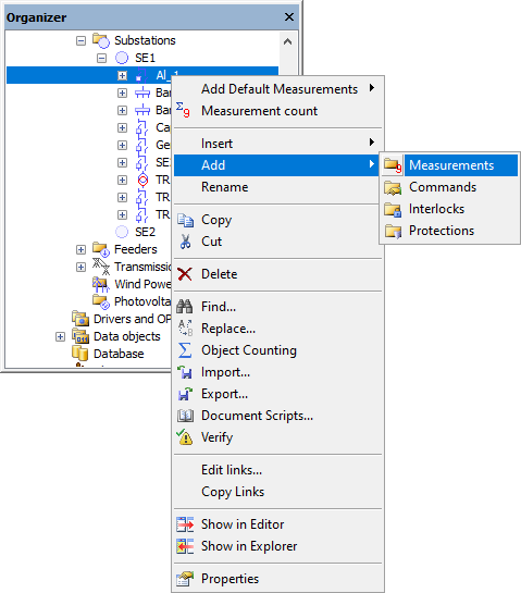

To add a Measurements folder, right-click an object and select the Add - Measurements option.

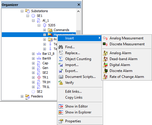

Once this folder exists, users can add several types of Measurements, Analog or Discrete. To do so, right-click the Measurements folder, select the Insert option, and then select a type of Measurement, Analog or Discrete.
Option to insert an Analog or Discrete Measurement
Inserting Measurements must always consider the location where this Measurement is requested. For example, if in the field on Breaker's Terminal 1 there is a current transducer, a Current's Analog Measurement must be added to Breaker's Terminal 1 in the application. On the other hand, if in the field a Breaker may or may not be inserted in a rack, a *BreakerRackPosition-type Measurement must be added to the application on Measurements folder to indicate that status.

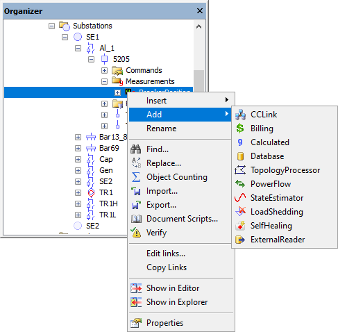

Inside a Measurement, whether it is Analog or Discrete, users can insert one or more Measurement Sources, indicating how information is received by an application. These Sources can be of input-type or from an Electrical Study.
To insert a new Measurement Source, select a Measurement, right-click Add, and select the type of Measurement Source.
Option to add a Measurement Source
