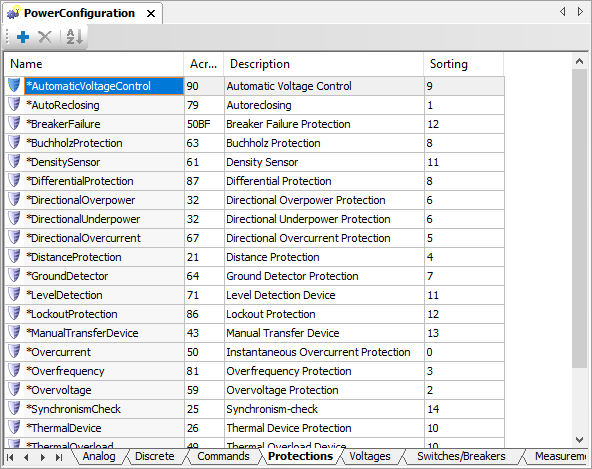

Registration of Protection types must be performed on Power Configuration's Protections tab. Some Protections are already provided by Elipse Power by default, such as Overcurrent Protection or Undervoltage Protection, among others. In addition to the ones already existing, users can also create new Protections. The types of Protections can be configured at run time in the object returned by the ProtectionTypes property of the Power Configuration object. The next figure displays the tab to create and edit Protection standards.

This tab's toolbar contains the options Add Add, to create a new type of Protection, Remove Remove, to remove a user-defined Protection type, and Sort Sort, which sorts the visualization of the list of Protection types.
The columns for each Protection standard are described on the next table.
Columns to edit Protection standards
Column
Description
Name
Standard's name. This can only be edited on user-created standards, which cannot have the reserved character "*" as its prefix. Corresponds to the Name property of the Protection Type object
Acronym
A free text configuring an acronym for this Protection type. This property can be changed even for Protections automatically provided by Elipse Power. Corresponds to the Acronym property of the Protection Type object
Description
Description for this Protection type. This text can be used to describe this Protection on a Display, to identify an alarm message, or any other view. Corresponds to the Caption property of the Protection Type object
Sorting
An integer used to sort, in a way other than alphabetically, the Protection types. This number is useful if Protections must be displayed on a table, but not sorted out alphabetically. This sorting mode is used if PowerExplorer's SortMode property is configured to 1 - smTypeSorting. Corresponds to the Order property of the Protection Type object
NOTE
Standard Protection types can only have their Acronym, Description, and Sorting columns changed.
