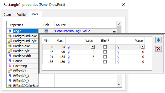

In a Table Link, users can establish a set of intervals based on the minimum and maximum source values and, for each one of these values, a value to be assumed by a property. In addition, as in a Digital Link, users can specify a Blink option and an alternative value.

The available options for this Link are described on the next table.
Available options for a Table Link
Option
Description
Add Add a new row
Inserts a new row on the table
Remove Remove the selected row
Removes the selected row from the table
Min
Specifies the minimum value on the source for a table row
Max
Specifies the maximum value on the source for a table row
Value
Specifies the value on the property to be assumed when the source is inside the interval specified on the table row
Blink
Determines that when the source is inside the interval for this table row, the property then alternates periodically between the values specified by the Value and Value <Blink Enabled> options
Specifies an alternative value of the property to be assumed when the source is inside the interval specified on the table row, that is, when the Blink option is enabled
To use this resource, follow these procedures:
1.Right-click an object and select the Properties option.
2.Select the Links tab, click the Link column of a property, and then select the Table Connection Table Connection option.
3.Add rows to the table and configure the respective Min, Max, and Value options.
4.If users must alternate periodically among values, enable the Blink column and then configure the Value column.
