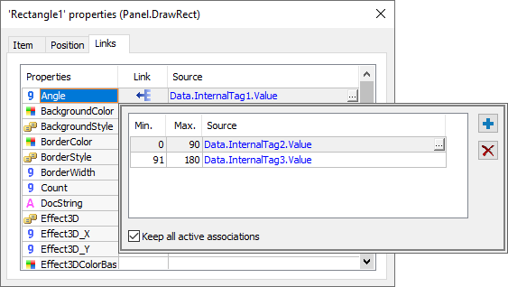

In a Multiple Link, each row of a Link allows retrieving its value from a different source. The active source is selected according to the Link's main source value.
Each row contains an interval, the Min and Max properties, and the source for that interval, the Source property, which is a Simple Link.
Multiple Link
Multiple Link
The available options for this Link are described on the next table.
Available options for a Multiple Link
Option
Description
Add Add a new row
Inserts a new row on the table
Remove Remove the selected row
Removes the selected row from the table
Min
Specifies the minimum value on the source for a table row
Max
Specifies the maximum value on the source for a table row
Source
Specifies the source to be linked to the property when the value of the main source is between Min and Max limits
Keep all active associations
Keeps all table Links in Advise, or active, mode. This option corresponds to the AdviseAll property
To use this resource, follow these procedures:
1.Right-click an object and select the Properties option.
2.Select the Links tab, click the Source column, and then select the Multiple Connection Multiple Connection option.
3.Add rows to the table and then configure their respective Min., Max., and Source columns.
