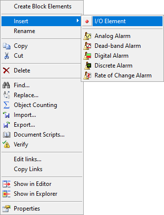

1.Right-click an I/O Block and select the Insert - I/O Element option.
Inserting an I/O Block Element
