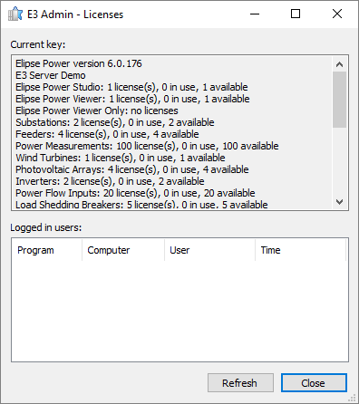

Users can view all available licenses via E3 Admin. To do so, right-click E3 Admin's icon on Windows Notification Area and then select the Licenses
option. The window on the next figure is then shown.
E3 Admin - Licenses window
Available options on the E3 Admin - Licenses window
