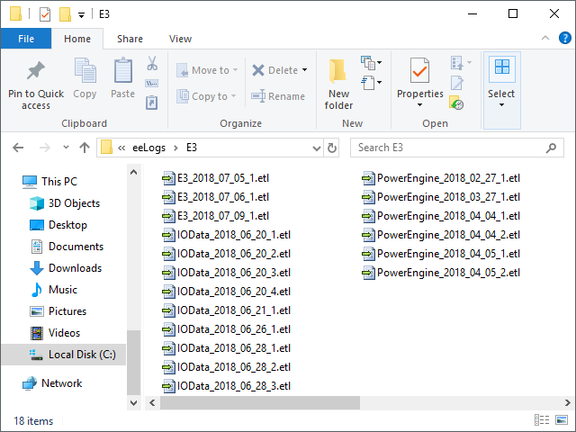

Elipse Power stores all significant events of its operation in logs in ETL (Event Trace Log) format. These logs store information about how Elipse Software systems work, such as computer's memory consumption and database operations, among others. Log files are saved on the c:\eelogs\e3 folder, created during installation, as shown on the next figure.
Elipse Power logs folder
The name of a log file informs its type and year, month, and day of creation. Main types are E3, PowerEngine, and IOData, that last one recording communication data with devices.
