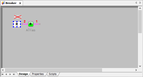

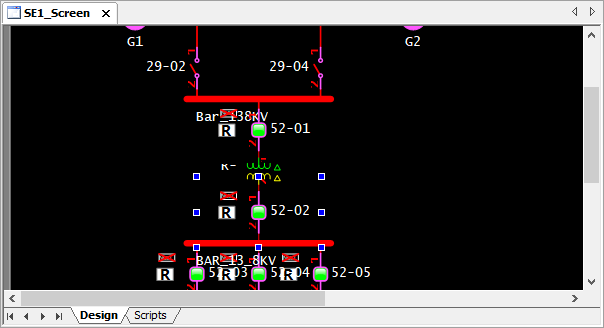

1.Use the shortcut key CTRL + X to cut the Display with the indication of Local or Remote, inserted on SE1_Screen near Breaker 52-02.
Display
Display
2.Select the XControl Breaker and paste the object (CTRL + V), placing it near the Breaker.
Breaker
Breaker

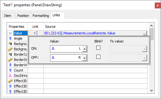

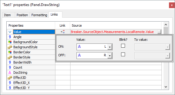

Let's adapt the Link source, which was previously created in the Value property. Now this Display must not point to the Measurement of Breaker 52-02 anymore, but to the Measurement of the Breaker that is linked to the Breaker object.
3.On the links window of this Display, change the source from "SE1.[52-02].Measurements.LocalRemote.Value" to "Breaker.SourceObject.Measurements.LocalRemote.Value". Use the F2 key to edit the Link text.
Link
Link
New Link
New Link

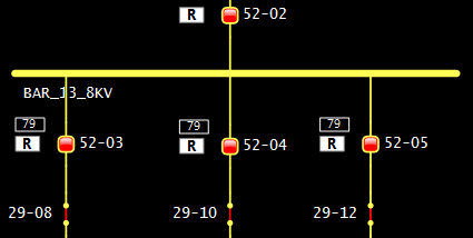

5.Execute the application and test this new functionality.
Application at run time
