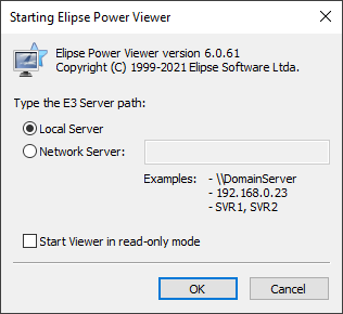

To execute a client application, users can access an Elipse Power Viewer, available on the Start - Programs - Elipse Power - Elipse Power Viewer menu.
Elipse Power then shows the following dialog box, so that users can inform an application's server path.
Starting Elipse Power Viewer window
If E3 Server is on the same machine as Elipse Power Viewer, select the Local Server option. If they are on different machines, select the Network Server option and inform either a name or an IP address of the machine executing E3 Server. If E3 Server is available in a port other than the default (6515), inform this port number in the Network Server field right after the IP address, separated by a colon. To connect in Read-Only mode, select the Start Viewer in read-only mode option.
