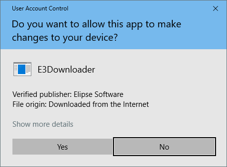

During server's first access, Internet Explorer starts component installation, in case it was not previously installed, as stated at the beginning of this chapter. This component is signed by Elipse Software, and users must accept that installation to start its configuration.
WebViewer Installation
After installation, WebViewer opens in Internet Explorer, and viewing a server's application. In the next access, it is not necessary to install components, and connection is faster.
