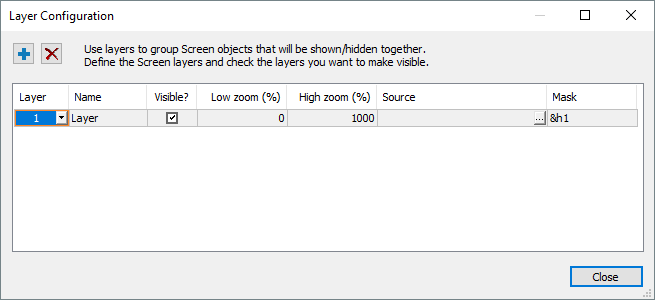

When the Edit Layers Edit Layers option is selected, the window on the next figure is displayed.
Layer Configuration window
Available options on the Layer Configuration window
Option
Description
Add Layer Add Layer
Adds a new layer
Remove Layer Remove Layer
Removes the selected layer
Layer
Indicates the configured bit, from 1 (one) to 32, for the selected layer
Name
Determines the layer's name
Visible?
Indicates whether this layer is visible on a Screen
Low zoom (%)
Determines this layer's initial percentage of zoom
High zoom (%)
Defines this layer's final percentage of zoom
Source Source
Establishes a Link or a property that, once active (different from zero), also displays this layer. The Zoom and Source options are not exclusive, that is, they can be activated when either conditions are active
Mask
Represents a mask, in hexadecimal, of the bit configured in Layer

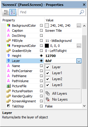

When clicking the menu of the Layer property on the Properties List of a Screen, users can configure the layers displayed on that Screen. This menu shows the layers configured on the Layer Configuration window and also the options All Layers, equivalent to the value &hFFFFFFFF in hexadecimal, or No Layers, equivalent to the value &h0 in hexadecimal, according to the next figure.
Options for a Screen's Layer property
