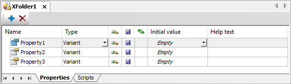

Properties tab of an XFolder
When inserting an XFolder, the View of this object is opened, where user can insert variables. These variables are Properties to be exported by this object, which can be linked to a Tag or to any other property of an application when this object is in use in an application.
The variables to export can be inserted by pressing the INSERT key or by clicking Add
and excluded by pressing the DELETE key or by clicking Remove
. The available options on the Properties tab are described on the next table.
Available options for Properties tab
Option |
Description |
Name |
Specifies the XFolder's variable name |
Type |
Determines the data type supported by a variable. Notice that other data objects (XFolders and XObjects) can be declared as data types. This way, users can create a data object that contains another data object as a Property. Data objects can work as a structure or as a class in this case, as in the C/C++ programming language. When specifying an object type, such as DemoTag, IOTag, or XObject, this Property displays the following behavior: •In case the ElipseX is inactive: This Property works as a String, which specifies the path of the object instance of the configured data type •In case the ElipseX is active: On writing, this Property works the same way as the previous case. However, on reading this Property returns the specified object, if it exists. If the path does not point to an existing object at the time, this Property returns Nothing This option corresponds to the Type property of a Property Definition object |
Public |
Enables or disables the visibility of a variable outside the Library, that is, determines whether a variable is public or not. This option corresponds to the Public property of a Property Definition object |
Persistable |
Determines whether a variable is saved in the project or not. This option corresponds to the Persistable property of a Property Definition object |
Retentive |
Determines whether this Property is retentive or not. This option corresponds to the Retentive property of a Property Definition object |
Initial value |
Determines the initial value of a variable. This option corresponds to the DefaultValue property of a Property Definition object |
Help text |
A text to declare and document a variable. This option corresponds to the HelpString property of a Property Definition object |

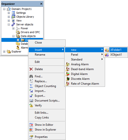

Users can insert XFolders in any Data Server, by right-clicking the Data Server in Domain mode, selecting the Insert option and then the name of the XFolder, as shown on the next figure. In Explorer mode, right-click the project's Data Server, select the Insert option, and then the name of the XFolder.
Inserting an XFolder in Domain mode
