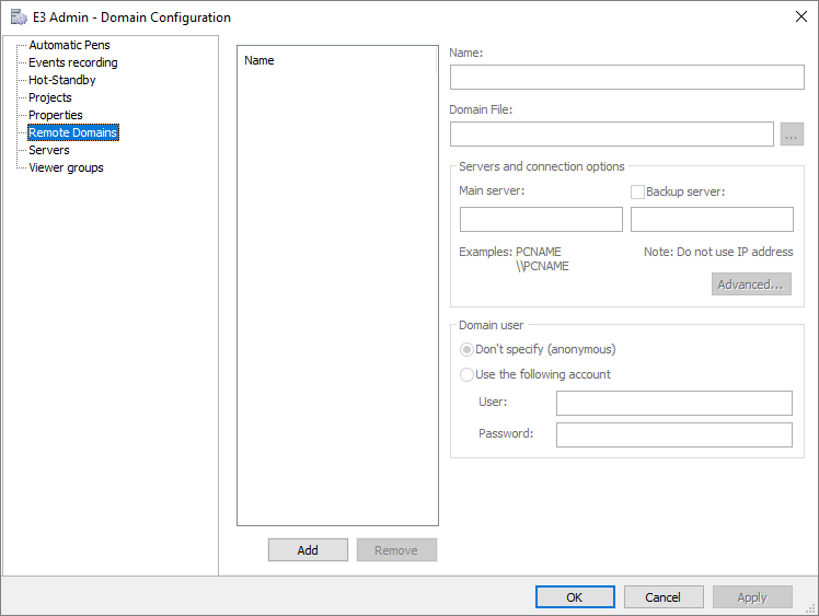

This tab allows adding, removing, or editing Remote Domains. Use the list on the left to select one or more servers to change. To open this item, right-click the E3 Admin icon on Windows Notification Area, select the Domain - Options Domain - Options option to open the window on the next figure, and then click the Remote Domains tab.
Remote Domains tab
Remote Domains tab
Available options on the Remote Domains tab
